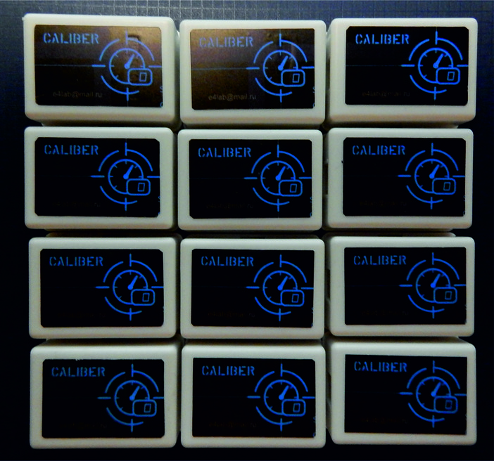

« Ответ #21 : 18 Марта 2018, 00:50:49 »
Добавили разъемы для Honda, Kawasaki и Yamaha.
Часть собранных корректоров:
Мото для которых подойдет корректор с разъемами:
SUZUKI
AN400 Burgman (1998-2006), AN650 Burgman (2002-2018), B-King (2008-2012), Boulevard C50 (2005-2018), DL1000 V-Strom (2002-2013), DL650 V-Strom (2004-2018), GSF1200 Bandit (2001-2006), GSF1250 N/NA Bandit (2007-2013), GSF1250 S/SA Bandit (2007-2016), GSF600 Bandit (2000-2004), GSF650 Bandit (2005-2015), GSR400 (ВСЕ), GSR600 (ВСЕ), GSR750 (2011-2017), GSX-R1000 (2001-2016), GSX-R600 (1997-2018), GSX-R750 (1996-2018), GSX1250FA (2010-2017), GSX1300R Hayabusa (1999-2018), GSX1400 (2001-2009), GSX600F Katana (1998-2006), GSX650F (2008-2015), GSX750F Katana (1998-2006), GW250 (2011-2017), Gladius (2009-2015), Inazuma 250 (2011-2015), Intruder 250 LC (2015), Intruder C800 (2005-2017), RMX-450Z (ВСЕ), SFV400 (ВСЕ), SFV650 (2009-2015), SV1000 (2003-2009), SV650 (1999-2014), TL1000R (1998-2003), TL1000S (1997-2003), VL800 Intruder Volusia (2001-2017), XF650 Freewind (1997-2004)
KAWASAKI
ER-4F (2010-2012), ER-4N (2010-2014), ER-6F (2006-2017), ER-6N (2006-2017), Estrella (ВСЕ), KLE650 (2006-2017), Ninja 1000 (2011-2013), Ninja 250R [Инжектор] (2014-2015), Ninja 300 (2013-2018), Ninja 400R (2010-2016), Ninja 650 (2012-2018), Ninja 650R (2006-2011), Versys 650 (2006-2018), Vulcan S 650 (2015-2018), W650 (1999-2007), W800 (2011-2017), Z1000 (2003-2013), Z1000SX (2011-2013), Z250 (2013-2014), Z300 (2015-2016), Z750 (2004-2006), ZRX1200 (2009-2015), ZX-10R Ninja (2004-2005), ZX-14 (2006-2011), ZX-6R Ninja (1998-2012), ZX-6RR Ninja (2003-2004), ZX-9R Ninja (1998-2003), ZZR1400 (2006-2011), ZZR600 (2005-2008), KLV1000 (2004-2006).
HONDA
599 Hornet (2003-2006), 919 Hornet (2002-2008), CB1100SF (1999-2004), CB1300 S/F (1998-2015), CB400SF (1999-2005), CB600F Hornet (2003-2006), CB600S Hornet (2000-2002), CB900F Hornet (2002-2008), CBF600 (2004-2007), CBR1100XX Blackbird (1996-2008), CBR600F (1995-2010), CBR600F3 (1995-1998), CBR600F4 (1999-2000), CBR600F4i (2001-2006), CBR600FS (2001-2003), CBR600RR (2003-2004), CBR900RR Fireblade (1994-2003), CBR919RR Fireblade (1996-1999), CBR929RR Fireblade (2000-2001), CBR954RR Fireblade (2002-2003), GL1800 Goldwing (2001-2018), GL1800 Goldwing F6B (2013-2018), GL1800 Goldwing F6C Valkyre (2014-2016), RVT1000R RC51 (2000-2006), ST1300 / Pan European (2002-2015), VFR750 (1994-1997), VFR800 Interceptor (1998-2006), VT125C (1999-2009), VT750C [Инжектор] (2007), VT750C/S [Карбюратор] (2004-2007), VT750S [Инжектор] (2007), VTR1000 SP1 (2000-2001), VTR1000 SP2 (2002-2006), VTR1000F FireStorm/SuperHawk (1997-2005), VTX1800 (2002), X11 (1999-2004), X4 (1997-2003), XL1000V Varadero (1999-2004), XL125V Varadero (2001-2006)
YAMAHA
BT1100 Bulldog (2002-2006), Bolt [без АБС] (2013-2016), Diversion [без АБС] (2009-2015), Drag Star (1999-2006), FJR1300 [АБС] (2003-2005), FJR1300 [без АБС] (2001-2005), FZ-16 / FZ-S (2008-2015), FZ1 (2001-2017), FZ400 (1997-2002), FZ6 [АБС] (2006), FZ6 [без АБС] (1998-2012), FZ6R (2009-2017), FZ8 [без АБС] (2010-2015), FZH150 (2015), FZN150 (2015), FZS1000 Fazer (2001-2015), FZS600 Fazer (1998-2003), MT-01 (2005-2012), MT-03 [без АБС] (2006-2013), Majesty 250 (2002-2012), Majesty 400 (2004-2013), Morphous (2007-2008), Raider (2006-2017), Road Star (1999-2014), Roadliner (2006-2015),<s></s> Royal Star [ВСЕ модели] (1996-2013), Stratoliner (2006-2015), Stryker (2011-2017), TDM850 (1999-2001), TDM900 [АБС] (2004-2006), TDM900 [без АБС] (2002-2013), TMAX 500 (2001-2011), V-Star (950cc и больше) (ВСЕ), WR250R/X (2008-2018), WR450R/X (2008), Warrior (2002-2012), X-Max 250 (2006-2013), XJ6 [без АБС] (2009-2015), XJR1300 (2004-2017), XJR400 (2002-2007), XT660 (2004-2015), XV1600A Wild Star (1999-2005), XV1900A Midnight Star (2006-2015), XVS1100 Drag Star (1999-2006), XVS1300A Midnight Star (2007-2015), XVS950A Midnight Star (2009-2016), YS250 Fazer (ВСЕ), YZF-R1 (1998-2014), YZF-R6 (1998-2018), YZF-R6S (2006-2009)

Написал автору топика на почту, он быстро ответил, скинул группу в вк почитать посмотреть инфу. Я решил брать) Отправил на следующий день сдеком. Пришло из Екб дня за 3-4, нашел нужный разьем подключил всё болт он. Настроил по инструкции предварительно высчитав разность в процентах между показаниями спидометра и GPS. Получилось аш 15% то есть. На 1к км на одометре было +150км, а на 10000 + 1500км что не мало) и считаю прибор полезным).
